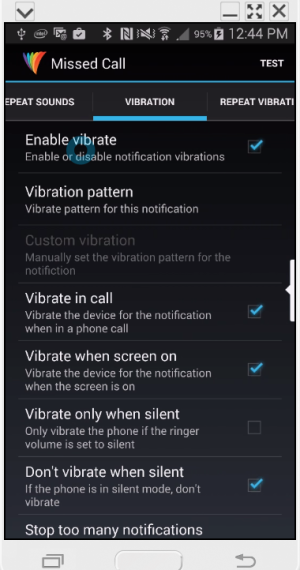

Due to the weak vibration I tend to not feel the vibration on my Moto360 from time to time. I've been searching for an app that would allow me to change the vibe pattern for months to no avail. My problem was solved by an app I already had installed on my phone. Yesterday Light Flow just updated their app to allow vibration patterns and repeating vibrations to notify your wearable device. I just tested this out and it works great!! I have mine set to 3 long vibes. I hope this app helps the people who complain about the weak stock vibration on their Moto 360. BTW I have no vested interest in Light Flow.
I just installed the paid version of Light Flow and I don't see the option for Android Wear. I see where I can add AW, but only for Wearable Connected and Wearable Disconnected.

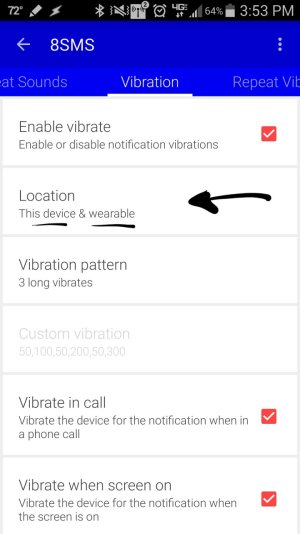

When Light Flow announced android wearable I couldn't find it too. It took me awhile to find where to set it.
Go to notification setting => Scroll to Vibration => Next category under "Enable vibrate" is Location (This device & wearable). That is where you set it. Hope this helps you.. If not, I can do a screen shot for you.. Let me know..

I don't see the option under Vibration that resembles "Location (This device & wearable)".
Can you point out what I'm missing?

Just downloaded yesterday so it is the current version, good to know it requires the paid version to work I must have missed that in the original post. I'd would really like to try before I buy but guess I'll have to take a chance or maybe try one of the other apps first.
Thanks again for the help
Yeah, mine is the lite version. Funny it doesn't list that as being one of the differences between the paid and lite version on their site.
