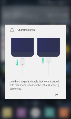

So my orignal v20 charger/cable is having some issue. Sometimes that pop up shows up sometimes it doesn't.
So I'm thinking of upgrading to Quick Charge 3.0.
Is it really an upgrade? Is there a noticeable change in charging speed? Or nah?

Hello, I faced this before a couple of times, there could be some reasons:
1. Your connection between cable and your device is loose
2. Your device port is not working properly
3. Your cable is not working properly
Change another good quality cable and see if still happens.
If it is because of the cable, you can look for Anker - quite expensive, but for sure it is cost-effective in the long term.
Hope it helps.
If this pop-up is your only concern, I'd stick with just replacing the cable.
The OEM charger on the V20 is QC2.0. As I mentioned in your other thread on your charging issues, QC3.0 isn't meant to be faster. It's meant to be more efficient. So in real world use, you're not going to see much of a difference compared to the OEM charger. It's unlikely your charger went bad, so I wouldn't replace that unless you are already wanting to replace it for other reasons. I.e. I have multiple devices to charge, so I got a 5 port charger I mostly use at home, or the car charger I bought for use at work. I bought these for convenience, not because I expected them to charge any faster than the OEM charger.
