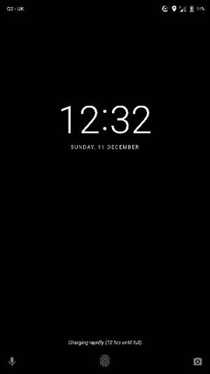

Been getting weird charge times
Help?
Takes about 3 hours to charge now
That is weird.
Try this: power your phone off (turn on, hold the power button for several seconds, tap Power Off), then plug in the charger for several hours or overnight to reach a full charge.
Power the phone on and use normally. The next time you plug in the charger, see if it reports a more rational "xx hours until full".
