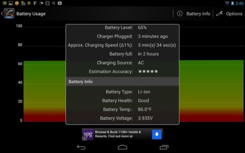

Another one is Gauge Battery Widget which gives much the same info and has a Pro version at $0.99. As I recall the N7 has a nominal 4300 milliamp-hr battery. With the given time for a 1% increase you can calculate the current into the battery. The stock charger is rated at 2 amps but the charging current allowed is controlled by the. N7 battery control software and is reduced as the. percent charge increases over about 50%. Operating the tablet when charging also may increase the time to charge.
Hmmm... So using Gauge Battery Widget my battery is at 25% with Approx Charging Speed of 6mins 58 sec. With a battery temp of 91.4F Battery voltage 3.784 Currently I'm using a Touchpad (HP) charger using a belkin 6' cable. I have Wireless off. I'm going to restart the Nexus to make sure nothing is running in the background to eat power.
Edit: With a Reboot and not turning on wireless the New info is
Approx. charging speed 3 min 9 sec Battery full 3 hours Battery Temp 91.4F Battery voltage 3.797V
On the OEM charger n cord, mine is anywhere from 2 min 40 sec to 3 min'ish per 1% with wifi on.....
via Battery Widget Reborn ...
I get 2 hours and 38 minutes with Daydream set to Currents (WiFI & Screen on) using generic 6 ft cable and factory charge adapter.
