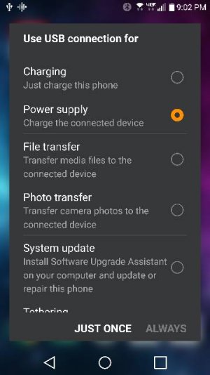

Have you ever seen this? This is the 2nd time today it's asked me this??

Either you have it plugged in to a computer, or that generic cable is bad and confusing the phone to think it's plugged into a computer. That screen shouldn't pop up if you're plugged into a regular charger.
Ok thanks...yeah that message popped up plugged into the original cord that came with my V20. I guess it has gone bad. Thanks!

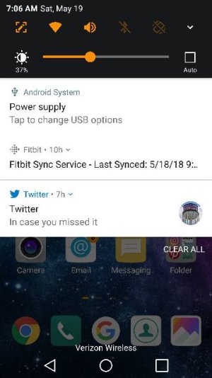

So now I'm getting this notification about a power source every couple of hours. I haven't plugged it into a computer or anywhere out of the ordinary. I made sure the charging outlet is clean...but still getting this message? Is there anyways to fix this?

Something isn't connecting right. Did you try canned air like the others suggested? If so, then I'm starting to think the port is going bad. It's not common, but does happen.
Yes I did try the canned air. No change. Odd thing is, I'm not getting the charging message when I'm plugging it in to charge...I was getting it all night long while it was just sitting on my nightstand. Being that it's an audible alert it's pretty irritating. I have no issues charging with generic charging cords...only with the original and the car charger both confirmed working just fine by other family members. Could there be something systemic in settings that got messed up? This is really odd
