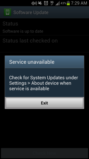

Is this what you get? Cause its all I get as well.

Here's a screenshot of what I get. As you can somewhat see in the background...there is no date associated with "Status last checked on". It has not been able to "connect" since day 1. Even though the Status says "Software is up to date," I'm sill on version I535VRLF2.
I ended up taking mine back because of it and they gave me a different one and I got the update right away with the replacement.
