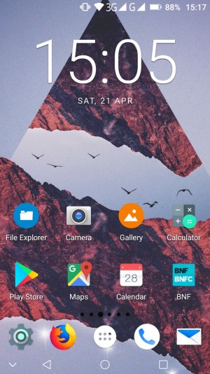

Here is a screenshot and a perfect example of the problem. All the times have all been correct for 4 days ( I check religiously). All of a sudden (see picture). The time in the top left when I pull the menu down was the same as the widget. The actual time was 15:20, which was the time displayed on the lockscreen clock. Help :(
