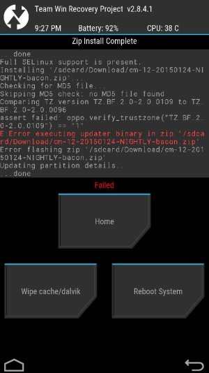

lrrowley Well-known member Oct 22, 2011 573 0 0 Jan 25, 2015 #1 I have downloaded 2 different nightlies for CM12 but neither of them will flash in TWRP. Each time there's an error. Has anyone else run into this problem? Do I just need to use a different recovery?

lrrowley Well-known member Oct 22, 2011 573 0 0 Jan 26, 2015 #2 This is what the error looks like Attachments 13467.jpg 56.9 KB · Views: 37
lrrowley Well-known member Oct 22, 2011 573 0 0 Jan 27, 2015 #3 In case anyone is interested, I found out you have to flash a file called 'CM12 Firmware' when coming from KitKat

M marioungui New member Jan 29, 2015 1 0 0 Jan 29, 2015 #4 You have to flash from pc using ADB and sideload method
