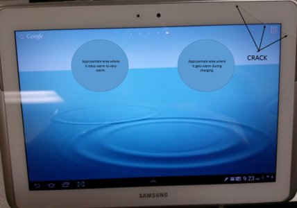

Last night I had a new twist in all of this. I fully charged my tablet before retiring for the evening. I always read prior to lights out. When I idled my Note and put it on the bedside stand I though everything was OK. It showed a full charge. This morning when I woke up it was completely discharged. Now this took place between 9:30 last night and 5:15 this morning. I also noticed something else. A crack in the upper right of the screen (see picture). I also noticed that the Note was very warm .... even though it was fully discharged.

Did you drop the Note, possibly causing the crack? If dropped, it may have damaged the Note or the battery, causing the discharge issue.
If you did not drop the Note, are you positive the crack was not there the night before? Or that you just hadn't noticed it until then? If you're sure you didn't drop it, and that it popped up on its own overnight, your battery could be swelling. This could put pressure on the screen and cause the crack.

All good points. I am very careful with my Note. I not only have a case for it, but I carry it to and from my school in a rather thick bag. I am certain the crack was not there.

I have the case removed now and have it on charging. Will see what happens. I have another tablet to use temporarily. The idea of the battery swelling is a good one. I am going to order the pry tool and a new glass this weekend. Giving thought to a new battery as well. I know I had a similar problem with my first Samsung phone. The battery did swell and cause problems. So will look further into that. Many thanks for your input.
