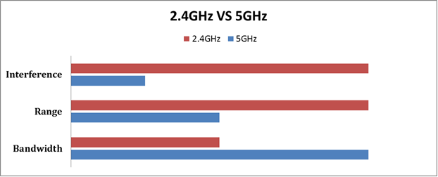

It's a tradeoff, higher freq carries more data/faster and can go further but is much more sensitive to obstructions.
Likewise lower freqs are slower/less data but less inhibited by obstruction.
