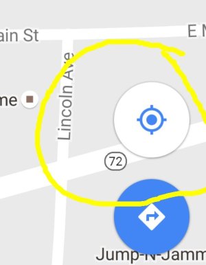

The compasses in smartphones are notoriously difficult to use properly; I honestly don't know why manufacturers include them since they must result in tons of support inquiries and bad feelings. If you enable GPS in your navigation app, it should quickly figure out which direction you are actually travelling in and override the false compass readings.

yea haha I know to tap that. and yea i mentioned I did the calibration figure 8 thing. Doesnt help.
