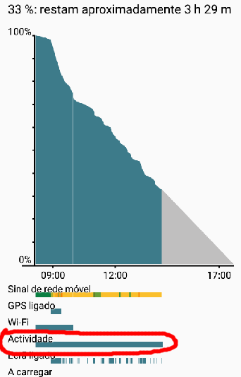

Hi,
I just got sometimes continuous activity on battery info:
It doesn't happen all time. Just sometimes, what can it be?
Something is keeping the phone awake. What apps are shown in the Battery stats as using the most battery?
1%-3%.
It normally occurs when I disconnect the S4 from charger dock... Could be the battery not good?
Those percentages aren't particularly unusual. A bad battery wouldn't cause the phone to remain awake. It could be some app that's forcing an inappropriate wakelock. Does this persist after a reboot?
Yes, sometimes. And it's a pain to know which app is, because sometimes it appears continuous and sometimes normal.
Use GSam Battery Monitor -- it might tell you what's causing wakelocks without having to root the phone.
Does it impact your battery life significantly? How does your battery life compare when that doesn't show up?

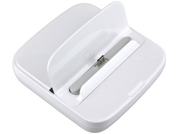

Dock is this:
Is it the battery it came with? My old HTC One M7 when I used a bigger battery it would do the same thing it would show 100% charged and then when I took it off it would rapidly fall down. If you keep it on that charger for extra time when it's 100%, does it still do it?
If I charge my S4 on the dock after charge it show continuous act.
When it's docked, are there any special features compared to when it's on a regular charger? If there's a dock mode, maybe that's inappropriately staying active after you remove it.
