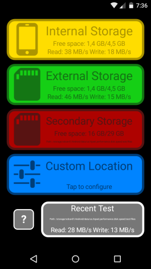

Today the internal storage speed was 38mb/s read and 18mb/s write.
The current Kingston 32Gb microSDHC U1 I already have in it, although from the manufacturer is rated at 45mb/s read and 10mb/s+ write, due to all the internals of the motoG, is benching at 28mb/s read and 13mb/s write!
So in theory if the 64Gb U1 microSDXC is performing around the same with this microSDHC card, then the data and apps in the "adopted" storage will be slower in access and write and this is a bummer :/
Here is the complete page with the speeds, the "secondary storage" is the microSDHC and the score is on the gray box bellow (for reasons only the dev knows) :P
