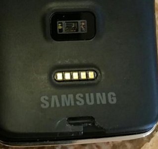

There's two places where the charging cradle design can cause breakage - the receiving clips on the Gear itself and the clips on the cradle breaking off. The latter's an easy fix (get a new one), the former not so much. There have also been far fewer reports of the former.

Mine broke. I use rubber bands to hold it onto the charger. Works fine.
