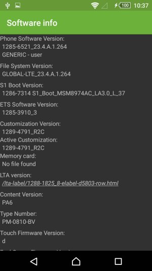

i have flashed "D5803_4.4.4_23.0.A.2.93_TR.ftf", and rooted.
i have flashed "D5803_23.4.A.1.264_1289-4791_R2C.ftf" and rooted.

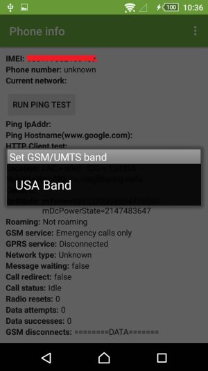

i have tried this: Firmware Mobile Tools: How To Remove Pattern Lock From All Sony Xperia Without Flash
i have tried this: [Guide] Unlock Z3c international band(s) | Sony Xperia Z3 Compact

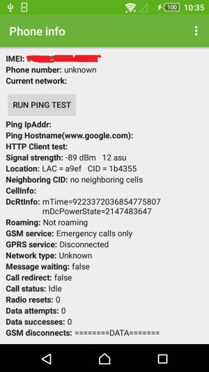

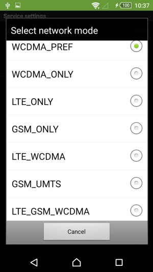

But phone can not connect to network..
it always says "invalid card. emergeny calls only"
- there is no IMEI problem..
Anyne have any solution for my problem?
Thanks...

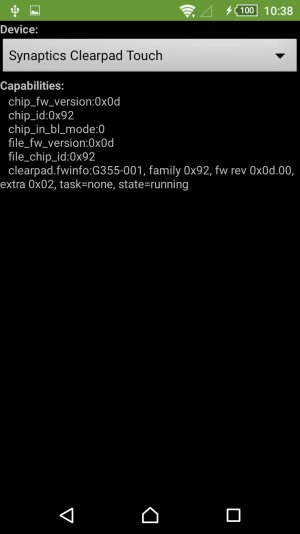

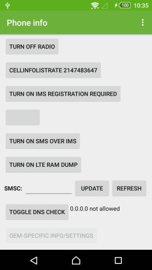

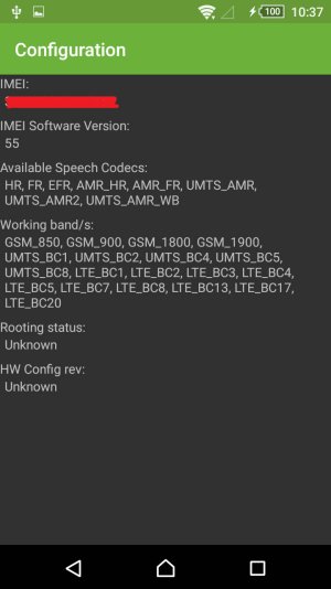

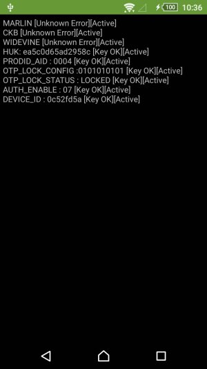

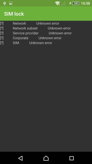

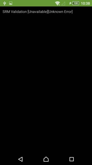

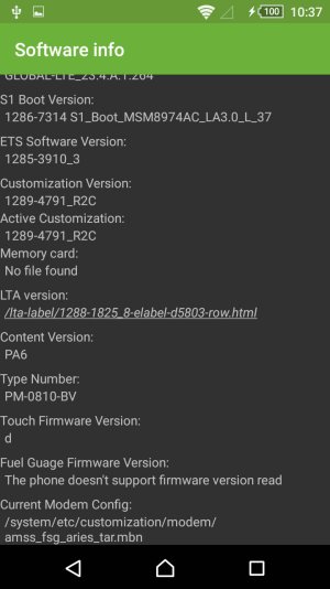

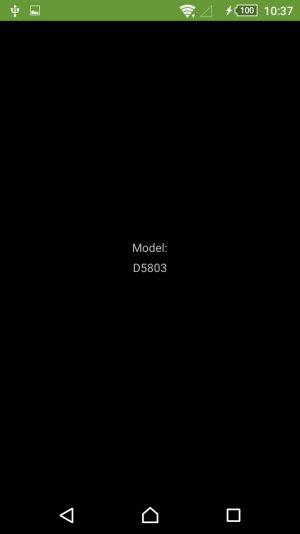

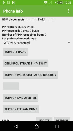

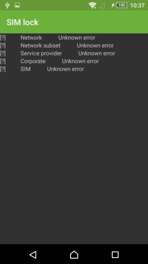

- i have attached screenshots of *#*#service#*#* and *#*#info#*#*
Screenshot_2016-04-09-10-35-30.jpgScreenshot_2016-04-09-10-35-40.jpgScreenshot_2016-04-09-10-35-49.jpgScreenshot_2016-04-09-10-36-01.jpgScreenshot_2016-04-09-10-36-46.jpgScreenshot_2016-04-09-10-37-07.jpgScreenshot_2016-04-09-10-37-20.jpgScreenshot_2016-04-09-10-37-27.jpgScreenshot_2016-04-09-10-37-32.jpgScreenshot_2016-04-09-10-37-47.jpgScreenshot_2016-04-09-10-37-57.jpgScreenshot_2016-04-09-10-38-06.jpgScreenshot_2016-04-09-10-38-13.jpgScreenshot_2016-04-09-10-38-20.jpgScreenshot_2016-04-09-10-38-20.jpg
