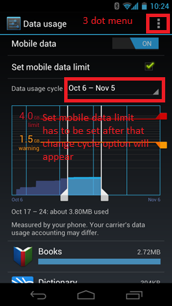

that option is available. maybe you are not looking at the right place.
settings-->data usage-->[3 dots on top right] inline with data usage on top.
"show wifi usage" is a checkbox.
to change the cycle. enable data then on mobile "data usage cycle" dropdown there will be an option called change cycle(the last option).
you have to have data enabled to change the cycle.

I am not trolling. Data enabled. Hit the menu/3dot button and get the following:
Restrict background data
Auto-sync data
Mobile hot spots
Help
No more show wifi, and the dropdown doesn't give an option for change cycle anymore.
