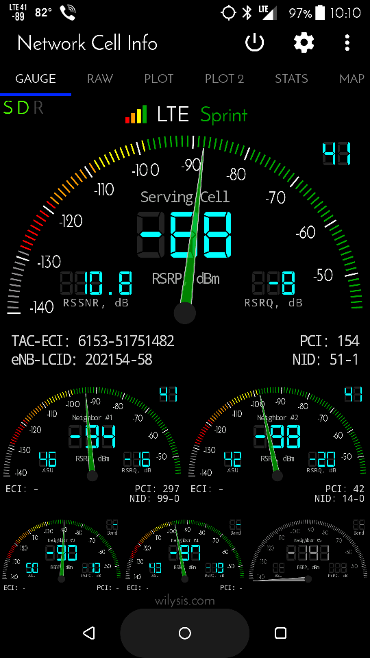

I am looking for any body who owns both the unlocked HTC U11 and a Samsung S8/8+ to compare the dBm for reception. I use AT&T but have a Verizon data SIM card too. If anyone has access to both devices and can tell me which one has better dBm for AT&T I would greatly appreciate it

Sure. HTC U11 - 98 and S8 - 91. Reading taken minutes ago, side by side on AT&T data.
OK, I redid the test a few minutes ago and got different results. This time, the U11 was - 89, the S8 was - 94 and I added my LG V10 which fluctuated between - 94 and - 96. Since I'm afraid to use my U11 much until my case arrives, I've only made a few test calls, but I had no problem and the call quality was good. No reviews have mentioned any signal or reception problems so I wouldn't worry. If you have doubts, buy from Amazon where you have a 30 day no questions asked return policy. That is well worth it than trying to save $50 through HTC.

OK, - 90 for U11 and, - 93 for S8 done at 7:03 Est. So U11 is doing quite well. I live in a suburb of Washington where AT&T has a strong signal. I would think the U11 would be as good as any other phone you've tried in your area. Samsung phones are known for good signal quality and the U11 seems even better.

@palmsolo @giper54 @ZDNet dBm is not the correct measure. SNR is ultimate arbiter of signal quality. S8 gets higher SNR from the same dBm level due to 4 antennas.
I set up the U11 today. dBm is as good as the Verizon iPhone 7 plus that I use on ATT sometimes a point or two better, a point worse but mostly the same. The only interesting thing is that it uses band 17 while my Pixel XL would use band 12.
Here are my results. On Band 4 ATT LTE S8+ has a better dBm reading and slightly better speed. Unfortunately where I live and work I use band 17. For band 17 LTE the U11 has much better reception. The S8+ even dipped down to 4G in my office. Looks like the U11 is the phone for me.
