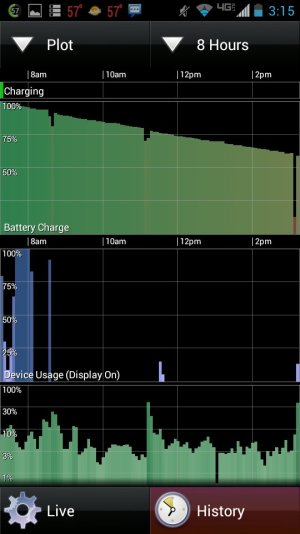

Aggravated to no end today....
Grab my phone (which I haven't used much today) and this is what o get for battery stats....
Ever since job its been worse... something goofed it up today.
I also noticed my WiFi turned itself on...
And this is the last 8 hours...
Not wanting too but I think fact reset this weekend is in order....
Sent from my DROID RAZR using Android Central Forums
Under Settings/Wi-fi, make sure you uncheck "Auto-connect to wifi."
Also, there's a decent amount of Cell Standby in your battery stats. Tap it--does it say that there's a significant amount of time without signal? Weak signal can definitely eat battery. Either you've been in an area with weak signal, or the update made reception a little worse for some reason.
