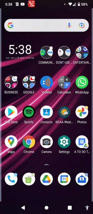

Dozens of posts on www. Settings. Accessibility. Accessibility Menu and Magnification. He's STILL THERE. see screenshot.

Blue horizontal lines and stupid little man lower right, STILL THERE
There are dozens of posts on the www telling us how to get rid of that little man. I have gone to:
  • Settings > Accessibility > Accessibility Menu
  • Settings > Accessibility > Magnification
and turned those off, but he is STILL THERE.
See the attached image:

If I tap the little man it brings up a white background at the bottom of the screen, with 2 icons "Switch Access" and "Boldbeast Call recorder." I have attached another screenshot, that does NOT show what I mentioned above, but take a look at the red square face with a diagonal line through it at the very top of the screen.Screenshot_20211204-173855.jpg
Sometimes I see a white "button" at the very top of the screen that reads "MENU," but I don't know what makes it appear. If I tap "MENU" I see several items: Brighter, Dimmer, just basic Android function buttons.
At times the square red face at the top of the screen becomes blue, without a diagonal line through it.

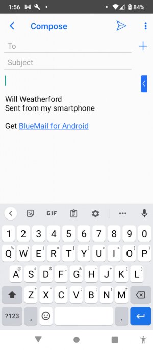

I'm afraid that I have already mixed topics in this thread... but to complete the thread I already messed up, and because I don't know how to post to another forum, I add the screenshot below.
In another post I have asked for How To Use AndroidCentral help.
Screenshot: see the special characters above all of the letters, and the row of large numbers. That is the keyboard I wanted.

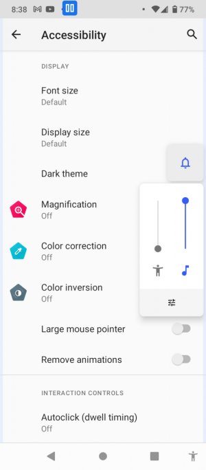

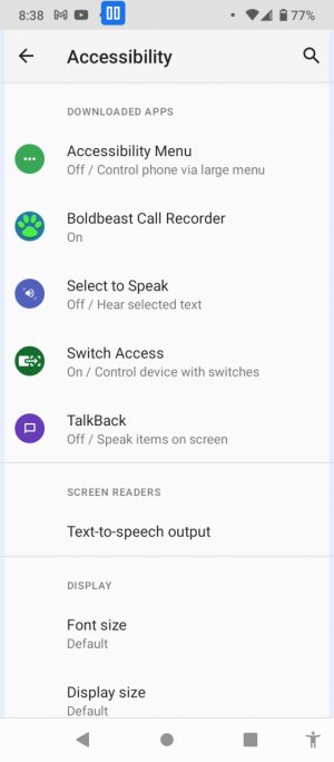

Accessibility menu is OFF. Mangification is OFF. See 2 screenshots attached. I still have the little man after going into Safe Mode and then booting up normally, did not help.

The Accessibility icon and the 'Menu' window that you posted on another thread are probably caused by a third party app. My bet is on that call recorder, BoldBeast.
I agree, see what happens if you uninstall BoldBeast. Also, try turning off Switch Access.
