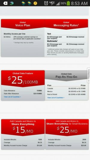

Verizon makes a killing off of international roaming. You should disable it in the settings. They charge $20,000 per gb of data for pay as you go data in all countries other than US, Mexico and Canada. Note that there is an international plan of 100mb/$25 for select countries. Though buying a local sim would cheaper.
Sent from my Verizon Samsung Galaxy Note 3 via Tapatalk Pro
