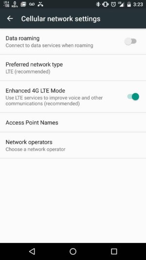

Do you have it set to find LTE (see below - "Preferred Network Type")?
