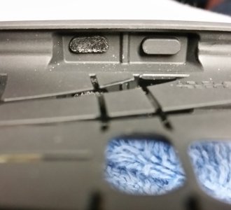

So here's what I just did. I didn't want to screw up the structural integrity of this case, by just cutting out the volume buttons entirely. But I'm a former electronics R&D technician and still have my tools around. So I removed the case and grabbed a small diagonal cutter and cut out JUST the rubber piece on the inside, that goes between the outer "Lower The Volume" button, and its corresponding button on the phone. Then I put the case back on. It works GREAT! What it does now, is that it makes it so that the case's rubber button on the "Volume Up" works just the same, as I didn't change that one, BUT the one for the "Lower The Volume" button doesn't make contact with the corresponding button on the phone anymore. IF I REALLY want to lower the volume, I can still do it, IF I press very deliberately - enough to push the outer rubber button down enough, so that it contacts the "Lower The Volume" button on the phone, but it SHOULD NOT be so easy to turn down if it gets lightly pressed or the leather on my cell phone pocket just pushes a little against it. I have to REALLY press it in now, and then it turns the volume down! So sometimes hardware solutions can work easier and faster than software ones. ;-) This whole thing just took me 5 minutes! :)

Good show on that case mod.
I think I shall investigate how the inside of my Speck CandyShell Grip case looks.

OK, here it is. My hardware "hack" ( literally LOL ). This was actually taken with the camera on my S5 and transferred wirelessly through my home WiFi using Airdroid. I'm surprised the camera focuses this close.
Samsung Galaxy 5 modification of down volume pad on Spigen Tough Armor case.jpg
