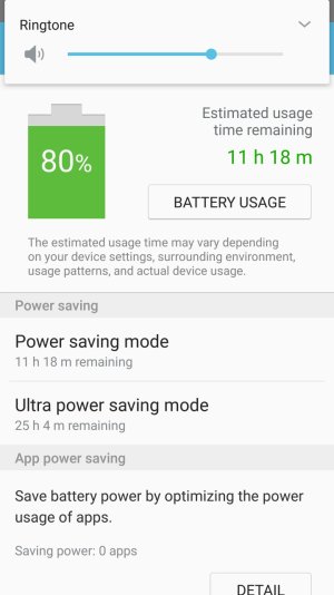

Battery: what? there is no cell signal strength there.......What I do have under battery, a picture of a battery and estimated time left, power saving mode with estimated power left and ultra power saving mode with estimated power left.Screenshot_20160407-114506.jpg
Not all devices have a native way of showing the cell signal strength. You can install a 3rd party battery monitor app like GSam Battery Monitor to give you that information. And the screenshot you posted does not reflect the other information I had suggested in my post. Make sure you charge up to 100% first, then use the phone normally until the battery level is down to 20-30% (not down by 20-30%). Then show us screenshots of what I suggested, as long as they can be displayed in your phone. If you can't find a list of battery usage by app in the Settings>Battery​ menu, then look in the App Manager.
