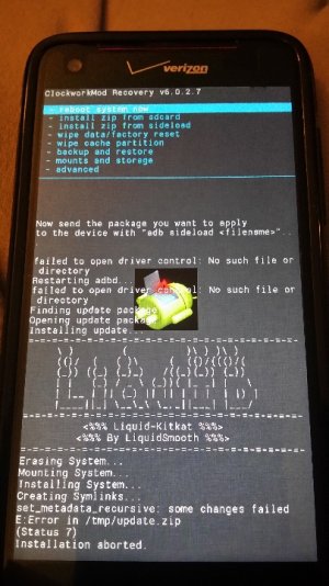

The problem with that turned out to be an outdated version of CWM. I updated it, only to find my phone would not get recognized in recovery by adb. Found that with the upgrade I also needed a driver upgrade which I took care of (after I had installed TWRP to test as well, just stuck with TWRP). Was able to flash rom (and it sucks). Looking for another one now that is more of a stock (de-bloated with perks, etc).

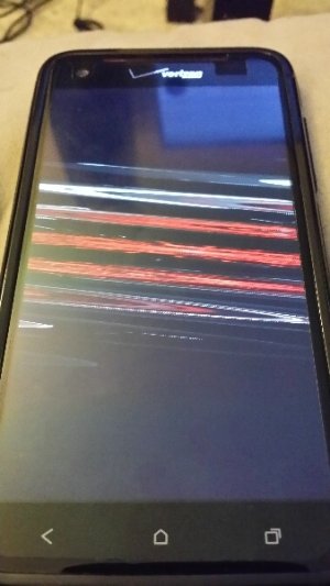

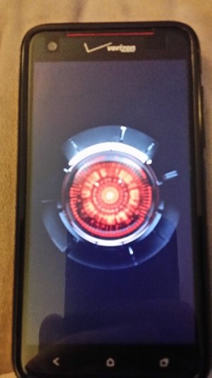

Here's another confusing element I'm dealing with......
So far, I've tried flashing four different ROMs. LiquidSmooth, Tiktak, ViperDNA, and Kitkat (stock).
Viper DNA hangs indefinitely on the loading screen (wiped and flashed three different times, all same result)
Tiktak and Kitkat stock both look fine for second on load screen, then the screen goes all distorted and squiggly, and freezes (photos attached)
So far, LiquidSmooth is the only one that actually works. I flashed it again and enabled dev options to turn on debugging. Would like to try getting S-OFF and upgrading the baseband to the current version thinking maybe that will help getting the Kitkat stock to work.
Any ideas on why the screen is distorting and freezing up on those two ROMs?
UPDATE
Looks like the problem causing the squiggly freeze was the baseband needing to be updated. I had re-flashed LiquidSmooth to get back into Android, enabled USB debugging, followed the firewater procedure, got S-OFF, updated the baseband, then finally I was able to install Kitkat. Looks like this old beast is up and running.
Now, for my wife's old DNA (which is not unlocked and still running stock post-OTA update). This could be fun...............
A word of advice, some newer ROMs might require an up to date version of a recovery. Are you using TWRP?

UPDATE
