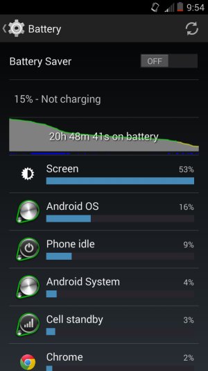

Installed the update yesteray morning and phone immediately started losing battery at a higher rate then I have ever seen on The Maxx. I bought this phone for the battery and have loved it the past six months, I got 2 days on it all the time. Now im seeing not even 24 hours. Cleared cache but that didnt help. Hoping it might return to normal.

Nothing seems out of the ordinary with your battery stats. Are you using the phone in the same places (No change in signal strength?) and using the it the same amount of time?

Using it exactly the same as I have been and at the same places. With About 2:45 of screen on time. Except the day before I downloaded the update i would have been at 35 hours of usage time to be at 15% and now just 20 hours. Wondering if maybe it will settle down and get back to normal after a full re charge from 0% to 100%. I really hope so bacause this phone is the best i have ever used.

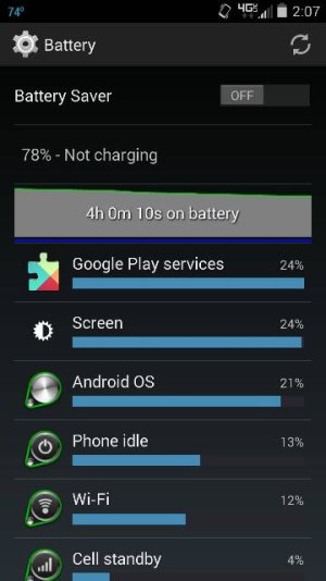

Yes my life took a dive after this new update. Thinking about factory resetting. Google Play services skyrocketed on my stat menu. I know in past updates for other phones Google would separate different stats that we may have been compiled into another, for example Android OS would include Google services before they separated and made it standalone.
So far I've tried clearing Play Service cache and it hasn't helped. Going to clear system cache in recovery if I can before I reset.

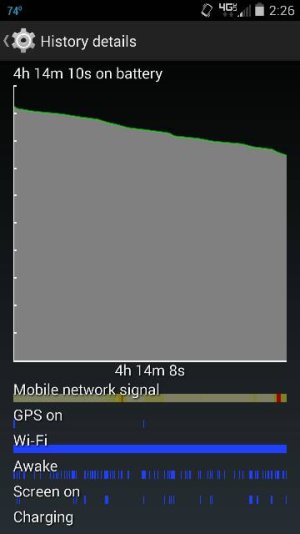

I've noticed that the awake time has increase as well. Here are some screenshot.

Yes, Play Services has been high for me a lot lately, but it was the same before the OTA.
There is a new update to Google Play Services that's been rolling out - 4.4.52, from 4.3.something last week. Unfortunately, you can't force the update; it comes when it comes. (Well, I guess you can sideload it if you get the .apk.) I don't check it every day, but I know it updated pretty recently, and maybe coincident with the OTA. Right now I don't have "Google Play Services" on my list, but I do have a "Google Services". It's at only 5%, though it's kept the phone awake 36 minutes in 5 hours 40 minutes.

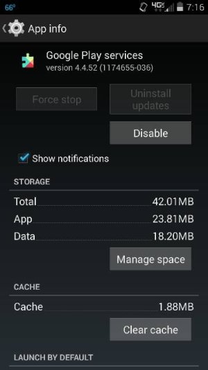

I've sideloaded the update for Google Play Services. Im unsure yet weather the new system update is displaying awake usage more correct now, or if my phone is more awake now.

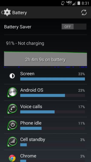

Well I let the battery get to zero and did a full re-charge over night. Unfortunately the phone is performing exactly as it has since the update getting me about half the time as it used to. 2 hours on with almost no usage and at 91%. Very upsetting to say the least. I can find no reason for it, nothing seems to be running in the background. Im thinking maybe a factory reset will possibly return it to proper functionality but i really have no idea if thats a legit solution. Cant put into words how pissed i am at verizon right now for forcing this update on me.
