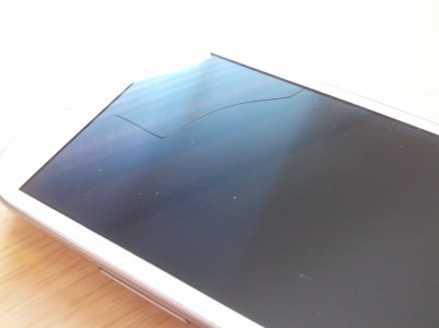

So I dropped and cracked my phone yet again, this is the Asurion replacement and I am not going to get another one again, moving on to the Note 3 though I really wanted to wait for the S5 but $100 for a new Note 3 I figured I had to go for it.
The phone looks flawless but if you look at the right angle you can see the screen is not cracked, the digitizer is cracked. Normally I crack the screen and not the digitizer and it functions fine. Screen is black, phone turns on, a little buggy though as I can't get anything to work...well I can't see anything but the problem is when I plug in the usb plug so I can save the contents of my internal sd card the computer does not see the phone. I am not sure why a cracked digitizer would do that. Any idea on how I can get the files of the internal memory?
Thanks.

I just swipe to unlock no password and when I used to connect it to my laptop I never had to unlock it atleast from what I recall? I am not sure exactly what is broke, the glass looks okay but it looks almost like a hairline crack under the glass. Here is a photo attached, you can only see that if you angle it towards the sun or light. Straight on you can't see it and the screen is smooth and flawless. Thanks for the MHL idea, I did that and I can see my lock screen on my tv, just won't let me unlock it, so it won't accept my touch I guess.
