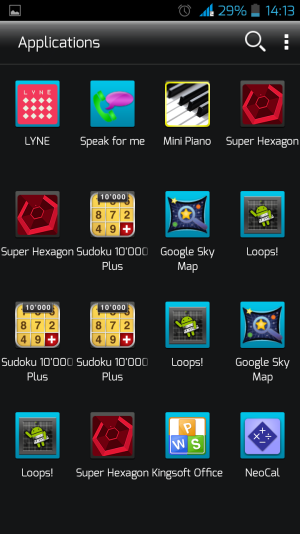

Hey all!
I'm on 4.2. My app list (the thing I get when I click the button with 6 dots) has loads of duplicate apps in it. If I try press and hold any of the apps, I get either "Move to Desktop", which I obviously don't want, or "Uninstall", which if I select, uninstalls the whole app (not just that duplicate). There any way to remove the duplicates?
Searching around the web I found that this happens when you move an app from internal storage to the SD card. Two suggestions to fix this were to move the app to internal storage and then move it back to the SD card, or to reboot. I tried both (one after another), but still no luck (in fact, I may have more duplicates now).
Any help would be appreciated!

Welcome to Android Central! What kind of device do you have? If you have the ability to wipe the system cache partition, I'd try that.

One thing to consider would be to go to Settings/Apps/All, select Launcher (or the equivalent), and Clear Data. You'll have to set up your homescreens again, but this might clear the App Drawer and force it to repopulate again. I've never tried doing this, but it might be worth a shot.

That worked! As you said, I'll have to set up my homescreens again, but at least I don't have 5 instances of each app in my list.
Thanks, I appreciate your help!
