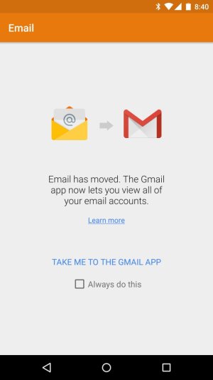

Why aren't you using the GMail app? That old Email app you are using is probably not Lollipop-compatible.

What app is it? Look under its Settings menu for "About" or something like that.
If it is Google's original Email app, I don't think it is being updated any longer. Hence the screenshot I posted above.
It's the standard email app that came with the device when I got it. It's just called 'Email'.
I understand I can switch to Gmail with my non-gmail email address, I just had been using Email for a year now and prefer its functionality.
In Settings - About it only shows the 'About Device' to see if there's an update available for the device. My device is up-to-date. I don't know how to check the app itself and see if there's an update for it. However, if, like you said, they're no longer supporting it, that may explain the issue. Just wish I had seen a notice or something to move over. I do like using the app, it's been my preferred method.
