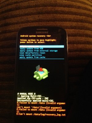

I got the same error when I did a factory reset and then it got stuck on the welcome logo. I got to the system recovery screen, I did a wipe cache partition, then a factory reset and tried to reboot but it still gets stuck on the samsung logo.
How do you get past that? I have backed up all the info i need so i'm not worried about losing data.
I don't know anything about softwares or what odin or kies are, so a step by step solution would be much appreciated!
