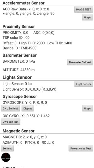

Hi, 2 days ago every sensor stopped working on ky galaxy s6 flat (auto rotation not working, auto brightness not working, proximity sensor n.w, etc.)
somebody could help me?
Thanks

The sensors aren't working for real.
I installled nothing but updates. I tried to reboot normally and in safe mode but nothing changed :/
Sounds like a hardware failure then. You had better contact your carrier or Samsung...
