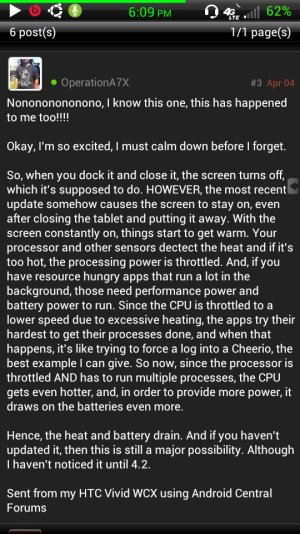

Nonononononono, I know this one, this has happened to me too!!!!
Okay, I'm so excited, I must calm down before I forget.
So, when you dock it and close it, the screen turns off, which it's supposed to do. HOWEVER, the most recent update somehow causes the screen to stay on, even after closing the tablet and putting it away. With the screen constantly on, things start to get warm. Your processor and other sensors dectect the heat and if it's too hot, the processing power is throttled. And, if you have resource hungry apps that run a lot in the background, those need performance power and battery power to run. Since the CPU is throttled to a lower speed due to excessive heating, the apps try their hardest to get their processes done, and when that happens, it's like trying to force a log into a Cheerio, the best example I can give. So now, since the processor is throttled AND has to run multiple processes, the CPU gets even hotter, and, in order to provide more power, it draws on the batteries even more.
Hence, the heat and battery drain. And if you haven't updated it, then this is still a major possibility. Although I haven't noticed it until 4.2.
Sent from my HTC Vivid WCX using Android Central Forums
