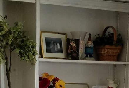

This is why the processing takes so long... that's a lot of pixels to sort through. But it's also its biggest advantage. I've posted these shots before, but it illustrates how well HDR+ works. The top image is a 100% crop HDR shot taken from a Samsung Galaxy S7, the bottom, an HDR+ shot from a Nexus 6P.
S7:
Now the 6P:
The difference in post processing between 'traditional' HDR and HDR+ processing should stand out. On the S7, you see a lot of digital artifacts... details are kind of chopped up a bit, colors muted. Look at at the Travelocity Gnome's face, the colors in the portrait of me and my wife, the details in the photograph of my son waving the flag, the curve of the vase. The white background in the S7 has a bit of digital smudge where the Nexus' has what I would consider something more akin to the grain you see in a film camera.
The S7's HDR processing hacks up the picture a bit because it is going through and artificially reducing noise and sharpening the picture algorithmically. Whereas the HDR+ shot is using information from the actual scene itself, retaining the information in the actual image, rather than processing it away. If you look at the two main images from above on a phone, the HDR+ image might not immediately appear to the eye as crisp, but it still retains the depth of the picture.... I kind of equate it as the difference between analog and digital audio.
S7:
Now the 6P:
