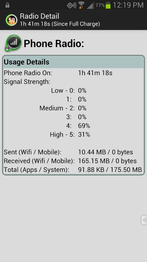

You could also provide a screenshot of the Radio Detail screen
in GSam Battery Monitor Pro: http://market.android.com/details?id=com.gsamlabs.bbm.pro (there's also a free version).

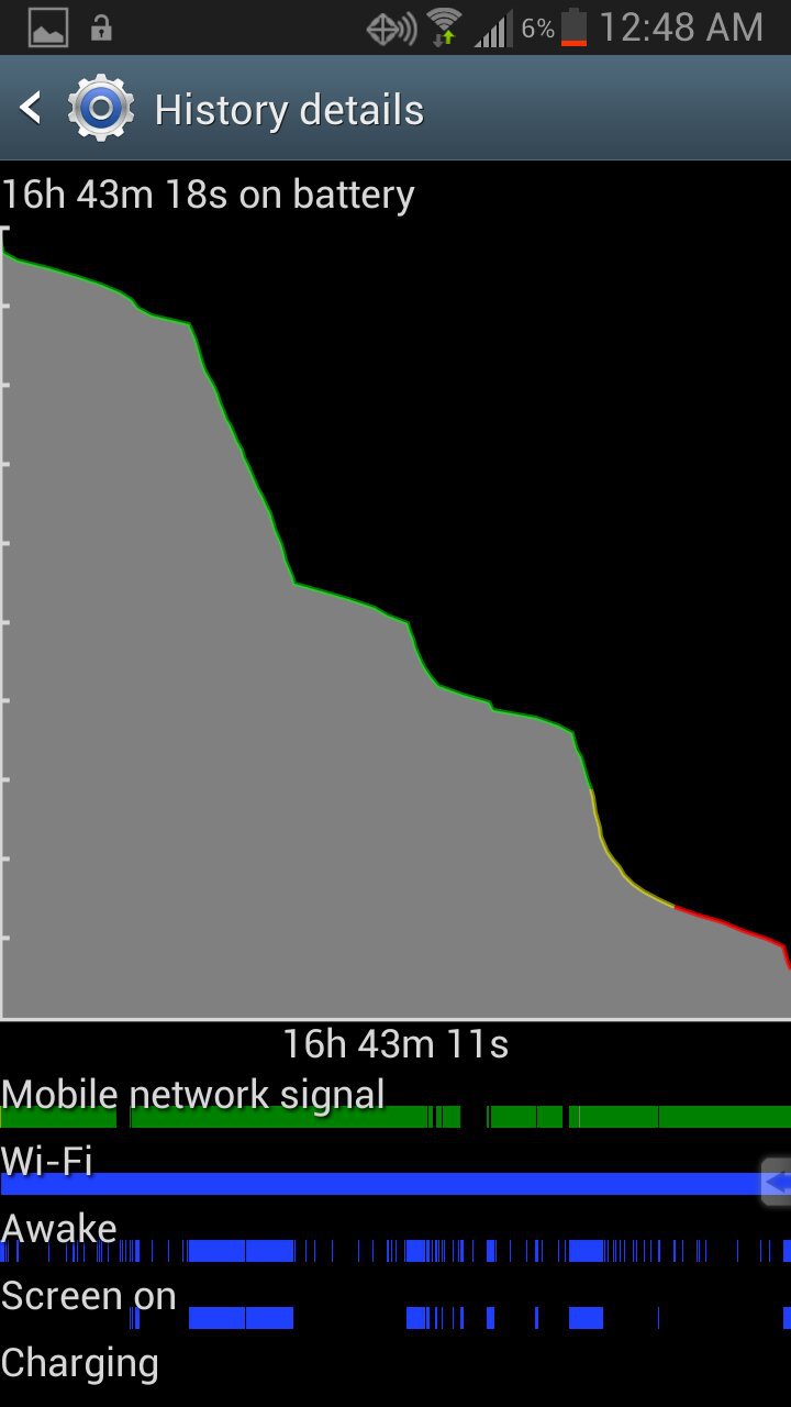

Edit: since your new battery is twice the capacity I'd expect about twice the performance, all other things being equal. That data was gathered at minimum brightness; mostly on Wi-Fi; good cellular signal; lots of bloatware disabled through Application manager.

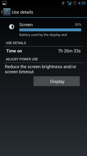

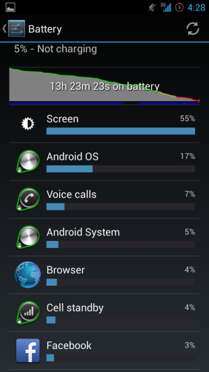

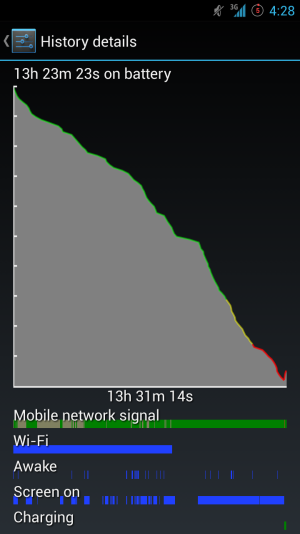

Ok, I managed to get some screenshots. It's certainly not what I would expect. With mobile data connected and WIFI off, 7.5 hours of screen-on time? I was expecting it to be closer to 11 hours.

Like Haalcyon said its probably defective because that's what i get on my stock battery on moderate to heavy use, and i get double that with my battery pack.
So you think it's a case of defective battery? Is there any other way that I can wipe the battery stats? The latest CWM recovery does not have the option to wipe battery stats. I'd like to think that the battery level is not being shown accurately, but if it really is a a defective battery I may have to ask for a refund and try another extended battery.
The extended battery I bought was a generic battery (no brand). Is it normal for these to be defective and not perform as you would expect? Are branded batteries like Hyperion and Gorilla better?
You get 7 hours of screen on time with a stock battery? Somehow I doubt that.
tkso, 7 hours is a LOT of screen on time. The big, bright hi-rez screens on these phones use a lot of juice. 13 hours total with more than half of that screen on is about all you can expect. With a stock battery, 2 - 3 hours of screen on time is all you can expect. I don't think there's anything wrong with your battery at all. About all you can do is turn the brightness down some more. Or buy a 7000 mAh battery.
