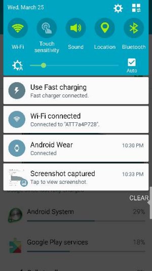

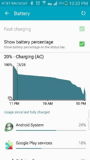

It doesn't look like I'm getting fast charging even tho when I first plug in my charger it say adaptive fast charger connected. Anyone know?

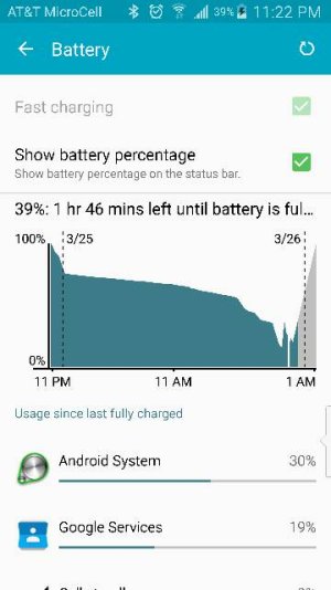

Yeah there is no way this is fast charging if it's gna take almost 2 hours to charge the remaining 61% if the battery.

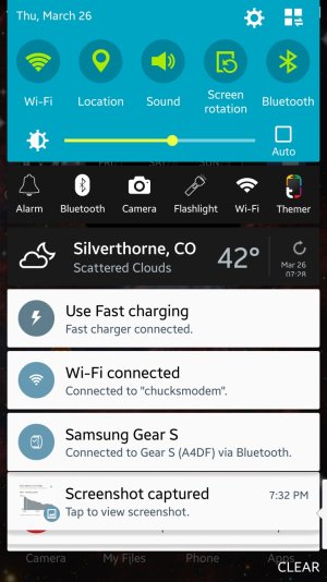

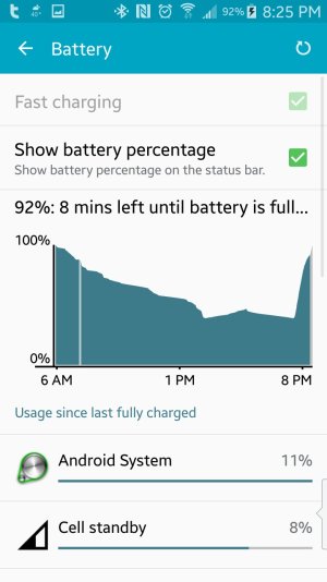

Here ya go. Think adaptive charge is working. I can also attest that wireless charging is just fine also.
