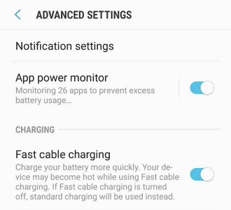

Also, you must have fast wireless charging turned on in your phone settings. You will find that under Advanced Features/Accessories.

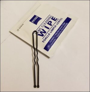

Try this... Below is pic what I used to clean the connector... I found a hair pin from my daughters room... thinner than a paperclip wire thickness and plastic coated to boot so no scratching the connector and tested by slowly inserting on both sides of connector and just the exact width to insert. And using a lens wipe with a alcohol mix, I drape the wipe tissue over the hairpin and gently insert and move along the each side rubbing the connector. Let dry and been testing and no issues... so far.

Just to update from my last post... since I cleaned the USBC connector using cleaning wipe on the actual connector, I've done a lot of short charges since then for the past two weeks using all the different cables I had used before and no longer getting random "Slow Charge" pop ups anymore. Must have been some residue on the connecter.
So I'm wondering if people get fast charging issues or even moisture message... try cleaning the USB contact inside the port on your phone. If residue was able to set off a slow charge message and even seen it knock my fast charge to slow charge while connected, I think it could also be possible it set off a moisture message.
