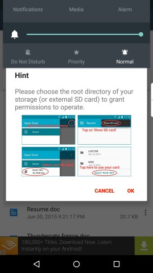

I'm trying to move a file from my phone to SD card and I keep getting an error pictured/attached below.
I tried on both FK file commander(paid version) and es file explorer with the same result.

This looks to be a common issue... and it seems the Priv needs the SD card formatted as Fat32 in order to enable read/write permissions.
The GUIFormat utility by Ridgecrop Consultants Ltd can help format SD cards bigger than 32GB as Fat32.
Is this an Android thing? Or something with how the Priv handles SD cards?
Sorted it all out.
Removed all items from my SD card and put on my PC.
Then re-formatted the SD card to FAT32 and replaced all removed items to card.
Attempted transfer, worked flawlessly.
Something to note that this does seem to be a bug in the exFAT driver on the Priv and I think a fix was coming. Using FAT32 on these huge MicroSD cards is not the greatest.

Sounds like you figured it out -- android requires you to select the 'SD Card' folder in that pop-up in order to allow any application to edit the files on your SD card for Lollipop+
