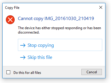

Is anyone getting an error when trying to copy files from a PC to the pixel?
"Cannot copy File name" "The device has either stopped responding or has been disconnected."
I have tried different ports and computers (both being Windows 10)

Yup! sometimes I can get it to copy a picture or 2. Oddly enough I tried using a usb 2.0 usb C cable instead of the usb 3.0 one supplied and it seems to be working better.
So I had this exact same problem using the front two usb 3.0 ports on my computers case, even though they worked fine with every other device. However all the ports on the back of the computer worked fine with the phone tried both usb 2.0 and usb 3.0 ports. No idea why it happens.
Oddly enough i attached the cable for the cases front usb ports to a different usb 3.0 header on the motherboard (I have two usb 3.0 heads on the board) and it works fine using the other lead. Very strange.
