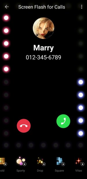

Hi, does anyone know how to get rid if the flashing screen I see when someone calls? I'm unable to answer and I get an advert at the end. I have a screenshot if that's helpful. It's not the usual call notification and just started after a recent update. I've searched all my settings and cannot find anything to turn off. It's driving me mad ! thanks

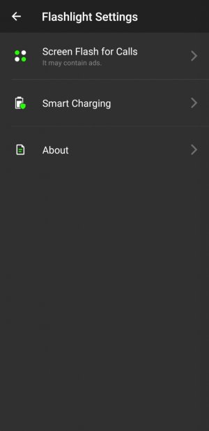

I found answer to the problem with Flashlight app. When you open it, it appears to offer an invitation to consider install flashing screen notifications, but if you click ok, it as if you accepted and activated it.
You have uninstall the flashlight app to get rid of the flashig sceen notification.
