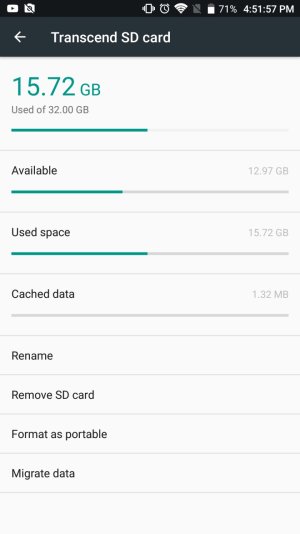

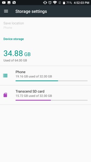

This should migrate any data you had moved to the SD card back to the phone's internal storage, although I'm not sure why it says it will free 301 MB on Phone. Check the SD storage info after you migrate, and see if it went down dramatically. If so, then you moved everything back to Internal Storage, after which you can reformat the card as Portable Storage.

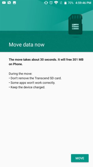

Okay I'm going to do the migrate, I will update when finished.

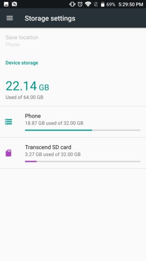

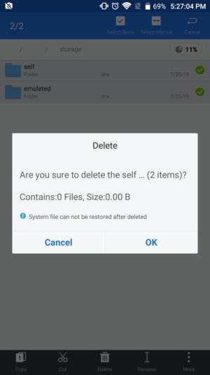

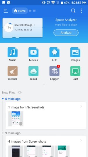

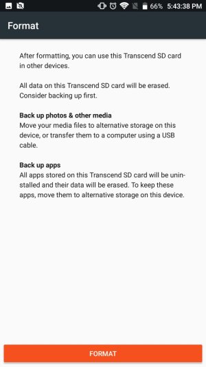

Okay so I did the migrate, and it seems to have deleted most of what I had on the SD card. It's still not accessible, but now it's obvious now it's set as phone storage since data has disappeared and the sizes match. It seems Its almost like its the internal storage I can't access. I went into ES and most of the files have nothing in them when they did before migrate. I went ahead and tried to see if it created a new general folder deeper in the system(far as I can go without root) which is a gance lin the third picture, I pressed delete to show the size of boh files holding everything I know on the phone. Both of those folders claim to be empty but they aren't. Nothing has been returned to it's proper place.

And this is what it says about formatting back to portable. I do not want to delete anything, and I hope I didn't.

You're looking in /DCIM/Camera on Internal Storage with the file manager to look for your photos, correct?
Yes and I also looked in Google photos and my gallery. They only hold the recent pictures I've taken or screenshots. It almost appears I'm looking on the SD card and only the SD card since it's set for internal. None of that data moved to the phone otherwise the original storag wouldve went up backup greatly near full storage. Before I started, phone storage was about 4 gigs away from being full.
Hmm, it's tough to say what really happened. Adoptable Storage can be a bit of a crapshoot, since some manufacturers implement it worse than others, which could lead to data loss. Another possibility is a corrupt or counterfeit card -- counterfeit cards are typically programmed to report more storage than they actually have, and if the user tries to store more data on the card than it can handle, that can cause various kinds of corruption or data loss.
