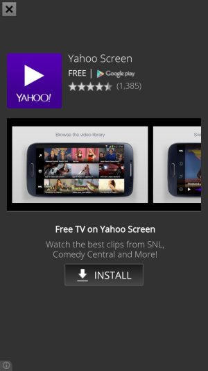

So i have been using a Galaxy S5 for about a month now... I noticed i was getting fullscreen pop ups and i though it was some downloaded apps and i removed them. But I am still getting them and i noticed it was only when I backout completely out of hangouts messaging app. If i press home or switch to another app I dont see the add. It has a grey background and the letter "i" on bottom left corner where i can press and it displays "ads by google".

The reason i think its something factory is because my wifes is not getting the pop ups BUT she did not turn off bloatware like i did. I am thinking that since i disabled i lot of the bloatware, they have it setup so that it then spams me with ads...Its very strange because NO ad detecting app detects the culprit of these fullscreen ads. Here is a screen shot of the adds. They always come with the same gray background/X on top corner and "i" on bottom, it just changes the content.

Well I am sad to report that it seems like it was Applock... strange because i had it for quite sometime (over 3-4 months) on my S3 and i never had gotten pop ups or ads at all... And its kind of hard to replace an app as nice as this one. Maybe ill try to install again later to see if using the "annonymous usage" reports doesnt throw me off as bad.
Updated: Applock now has a little account center thing now where you decide how your licensing is going to be with the following options: Premium paid, Premium with Ads (Default) or Basic no ads. Its kind of tricky to get to the account center which is why i never saw this (not via settings, you have to tap the top "ACCOUNT CENTER" text that blinks with other scrolling texts)... But seems like prior installations had the default to Basic instead of Premium with Ads which is why i never had pop ups on my other devices. Just though i clarify for other users.

I think applock is the culprit(and they openly mention that).
Try opening applock and inside left sidebar menu, tap first item(or menu header) called 'Account center' or 'Upgrade to Premium' and there you can see that it either shows banner ads or full screen ads.

Disable Applock app ..i guess that is the culprit..u can nitice it by pressing recent apps button right about when u are getting that advertisement.. applock will be on the list at that time...so try to remove that
