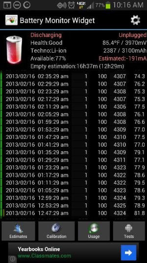

My personal preference is not to leave it on the charger after it is fully charged for the note 2 . It is not recommended to maintain a full charge for extended periods of time, it isn't good for the longevity of the battery. Some phones will charge to full then automatically discharge maybe 5% or so then recharge, continuing that cycle. The complaint that some people have is, how come it drops so fast, from 100 to 95% in such a short time.
Now, on the note 2, the phone remains at 100%, not following the charge discharge cycle i mentioned above, see the screen shot below.
I realize that a lot of people do what you do, and it certainly isn't gonna kill the battery overnight, but just saying that it is not ideal for the battery.
