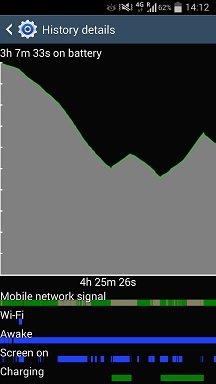

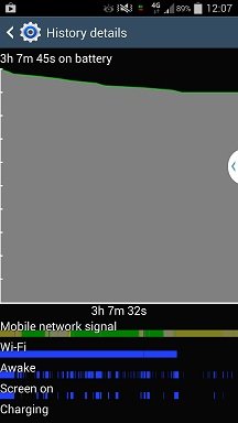

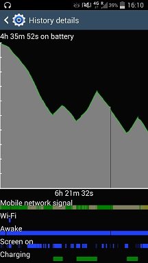

Update from Korea. I had data roaming turned on. I tried what RoyT99 had suggested, but the only difference is that I did not disable network lock prior to leaving Singapore but manage to do it successfully (I think) via the Singtel Mobile app when I was in Seoul. However, the problem persisted. I will test again when I go to HK next week, and follow RoyT99's steps exactly.
Also, as RoyT99 said in an earlier post, the phone does not go to sleep while on roaming. Something is definitely wrong there. It's true, whether or not wifi is on/off, data roaming is on/off, phone is charging, etc.... the last picture is when I was back in SGP.
Screenshot_2014-08-27-14-12-471.jpg Screenshot_2014-08-27-16-10-071.jpg Screenshot_2014-08-28-12-07-491.jpg
