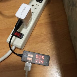

Use this one to help you to verify your tablet is charging, current should be 1.7 Amps

There is no guessing if problem from USB port, cable, or charger by this simple USB voltage current meter

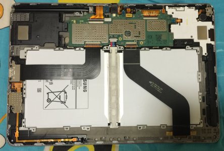

The USB flex charging port is on the left side and it's not related to the battery connector which is at the center.
Try to test your cable , charger, and USB port first. If nothing is changed, your problem most likely are battery connectors. I buy and sell more then dozen of Galaxy Note Pro tablets, first thing I do is resolder the battery connector and adjust the tips of battery cables from the white battery connector. All sold Note Pro tablets, I haven't received any call back from buyers. Problem from this tablet is very easily fixed but most people don't know how to do it because it requires soldering skills. Reading the threat " flickering screen " you will see all details how to fix these problems: flickering screen, auto shutdown, slow charging, battery capacity fluctuation, auto restart....etc,...all come from battery connectors.
Problem likes yours, it takes me only 10 minutes to figure out what is wrong: if USB port is working fine, the problem only comes from battery connectors. The worst is defective charging circuit but it's a rare case.
Well, you've covered most of my problems. Ridiculously slow charging even when powered down, what seems like quick discharge, battery capacity fluctuations. I purchased new cables, adapters and a monitor. Cables/adapters work fine on my Turbo II . Monitor says the tablet is drawing .4amps at 5.2V. So when/what is the symptom that points to the need to replace the battery?

Your charging current is only 0.4 Amps indicates something wrong with your battery connector as your charger and USB cable are working.
In normal condition, the charging current should be around 1.7 Amps. If it's only 0.4 Amp, some solder joints are cracked open.

For any tablet, with a voltage current meter, known working charger, USB cable, and USB port flex cable, I can find the source of problem within 5 minutes. Begin with charger, then USB cable, if nothing wrong is found, I can start swapping the USB charging flex cable right on the spot, disconnect the current one and connect the new one to mainboard, then test it. This method of elimination only take 5 to 10 minutes to find the bad part.
