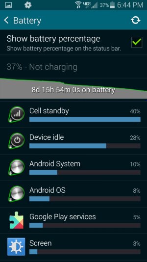

oh, the wife's battery screenshot? here it is... again, this ain't going to be your normal battery use scenario. Reread how she uses her phone.
