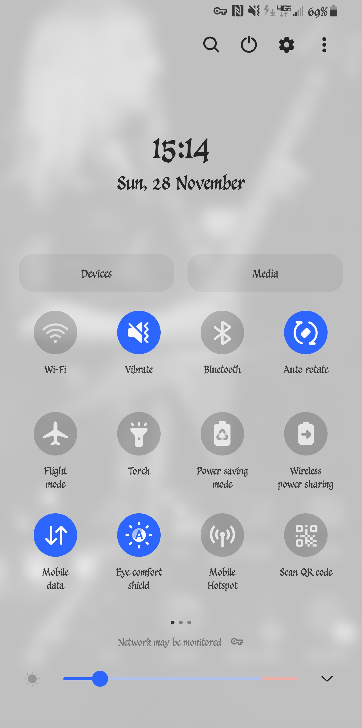

Today my Galaxy s10+ started having a yellowish tint to the screen. Blue filter is off. Tried changing the screen option to vivid. And changing the colors manually. Did not work.
Absolut tried the Google books thing. Also no luck. Anyone know how to fix this?
Does the yellow hue show up at the boot up screen? Or in Safe Mode? If so, your screen is damaged. ??????
Do you have eye comfort shield enabled? If so, does the yellow tint go away if you turn it off?
Unfortunately, yeah, if it persists in Safe Mode, this almost certainly points to a damaged panel. The 'nail in the coffin' would be to check the boot-up Samsung Logo. If that has the yellow tint, it's absolutely a hardware issue.
