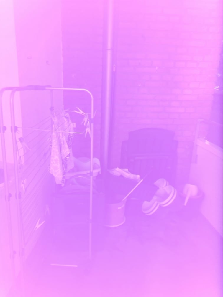

Got this S20 (it's my wife's)
When taking pictures in night mode all the pictures gets this pink layer.
Jo darkere jo more pink.
Anyone with tips to prevent pink pictures.

Did that. Its the same pink picture.
The funny part is if I use ultra wide then the picture is okay.

Strange , try reset the app by long pressing the camera, tap info then scroll to storage , clear data,cache force stop. See if this helps

Nope, its the same. All other modes works.
BTW 3x zoom in night mode gives pink pictures as well.

Can try to Uninstall the update to the camera , same long press but at upper right corner tap 3 dots , if this doesn't work maybe contact Samsung for Warranty

Still the same. Anything else works fine.
Seems she have to get the phone in for service.

Yeah , have Samsung look into this , should still be warranty. Your welcome!
i had that issue before on my Canon 1DX...its the sensor...
This is what I was thinking when I read it. Something hardware related because it wasn't happening at any zoom or other conditions on the other two sensors. I remember when HTC had this issue one of its devices. I want to say the Incredible, but it may have been the buttons on the Incredible and the camera on the Rezond. Anyway I tried messing around with mine last night when I read this and did notice a hue change but nothing drastic like the image shown.
Before I read Hermes Hidayat's comment I was thinking of asking if the actual subject had to be in a darkened environment or if just meeting the requirements as you explained them regardless of the lighting would cause this?
I also didn't notice any mention of whether or not the preview before taking the pic had this coloration or if it only appeared after the photo was taken? You get some software effect during the preview but there is some software editing post capture. If this only appeared post capture I might be inclined to think it was software but if the preview looks like this I'd be more inclined to think it was hardware.
Took this little video to show how it’s look like.

Sent the phone to service and they just told us, that they had to replace the rear camera on the warranty of curse.
Now we are just waiting for the phone to be sent back from the shop.

Ok good , hopefully won't be long !
