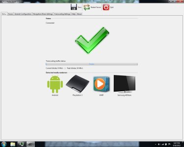

I'm going to try out your suggestion, mlebl1h. As for streaming to my phone using PS3MS, it started working properly tonight when I got home from work! I've attached a screenshot for the heck of it.PS3MS cap.jpg
Before, when I couldn't stream through PS3MS, the "Samsung Allshare", PS3, and WMP icons popped up with a "Unknown Renderer" icon. This time, it sees that I have ANDROID!
