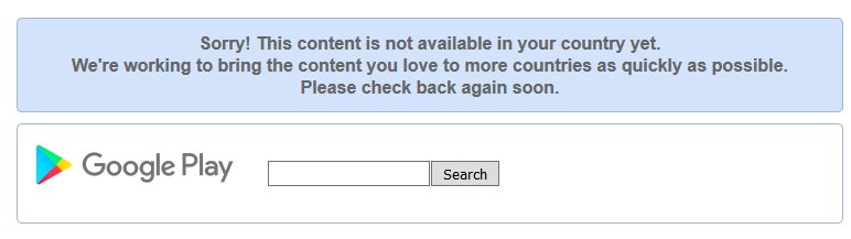

Can somebody share the link to download the apk of "Ringtone Fixer 1.0.5 APK".
Even if I can know which country people can download I can ask some friend to help me. 1.jpg
