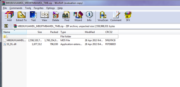

The other day I was trying to revert my Samsung Galaxy S IV (T-Mobile SGH-M919) from Cyanogenmod to Stock Touchwiz again. I tried following a couple of tutorials around the internet in order to properly do it, most of them, if not all of them, said to use Odin and to use this file in order to revert it back:

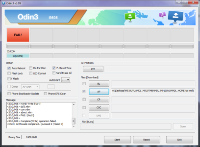

When I used it in Odin, and and followed the directions given, I'd get a fail error like this:
I tried to redo it a couple of times, each time I had the same error, and could not revert back to Stock. Then I thought that maybe it was because I had the MD5 file I needed, but the download didn't include a PIT file as well. After a while, I just gave up on trying to revert my phone back, and tried to restart it into my Cyanogenmod again. Once I restarted the phone, this error came up:

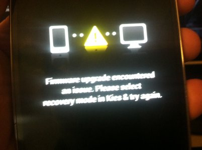

I can't access the operating system, the only thing I CAN access is the Downloading thing you use for Odin. I searched google and looked for others who had this same issue, and none of their solutions works. I've also tried to use Kies to restore the phone, and Kies didn't even recognize anything was wrong with the phone.
If anyone has done something similar, or knows how to fix it, I'd appreciate learning how :) (And I'd rather not have to buy a new phone and have to pay the rest of the $528 I still owe on the phone :P)

Did you make sure kies did not have a process running in the background while using odin? All kies processes need to be killed before using odin.
Another thing, before running cyanogenmod, what stock ROM version were you running? After MK2, you can't flash older stock rom tars due to the bootloader (can't go back from MK2+ to MDL)
As long as you can access download mode you can restore. Take that same picture, but from download mode, make sure its close enough so I can see the text on the screen.
Extra things: the md5 is already built in the tar, and, you never use a PIT file with odin for just flashing stock roms. An md5 check failure will let you know it was that. This is completely different, this is an authentication failure right after flashing one of the bootloader images (aboot.mbn). My assumption right now is that you were on MK2 and you are flashing MDL, which you can't do. But still, I need that download mode picture.

You were on MK2 (4.3), and you were trying to flash MDL (4.2.2, as per your first picture). The bootloader is locked against downgrades. Also, the bolded part indicates your warranty is void (another pointer that you were running MK2 and can't downgrade).
You need to flash an MK2 stock tar file (M919UVUEMK2). Register on this website (sammobile.com), so you can download the tar file from this link
