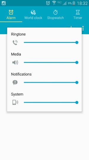

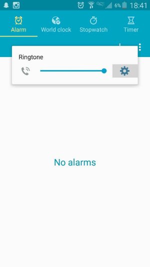

First off, make sure your sounds are all the way up. Not just you ringtone, but your system and notifications too, because I have found that just doing the ringtone doesn't make all of the other sound options go up with it. (I currently own an S5 Verizon G900V and I'm sure that the S5 and S6 have the same sound options.) What you want to do is either turn up your volume (Picture 1) and hit the gear button. That will then expand the menu to all of the sound options and not just ringtone volume. (Picture 2)

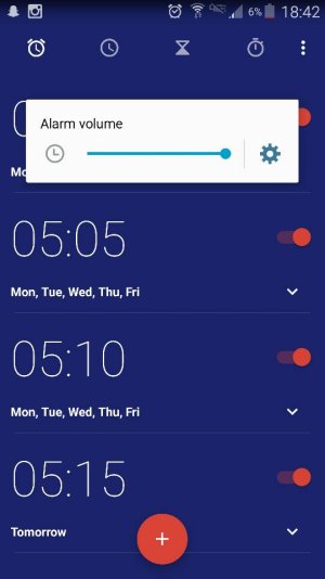

If neither of the two above options work, try the Google Clock app. I tend to use it more, not because the Samsung one is bad, but because the Google clock is analog instead of digital like on the Samsung Clock. There is also a separate sound setting for alarms you can adjust once in there (Picture 3).

Well I guess picture two got cutoff:
Posted with my S5 via the Android Central App

And one:
